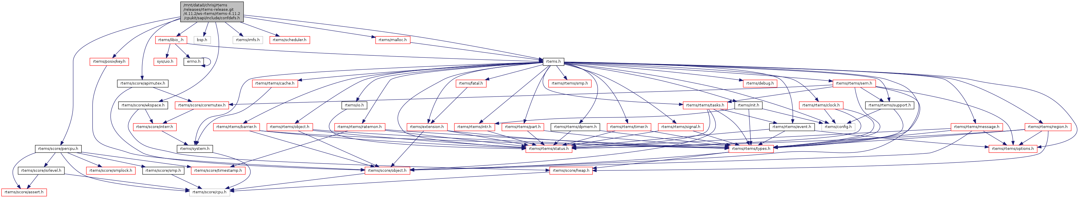

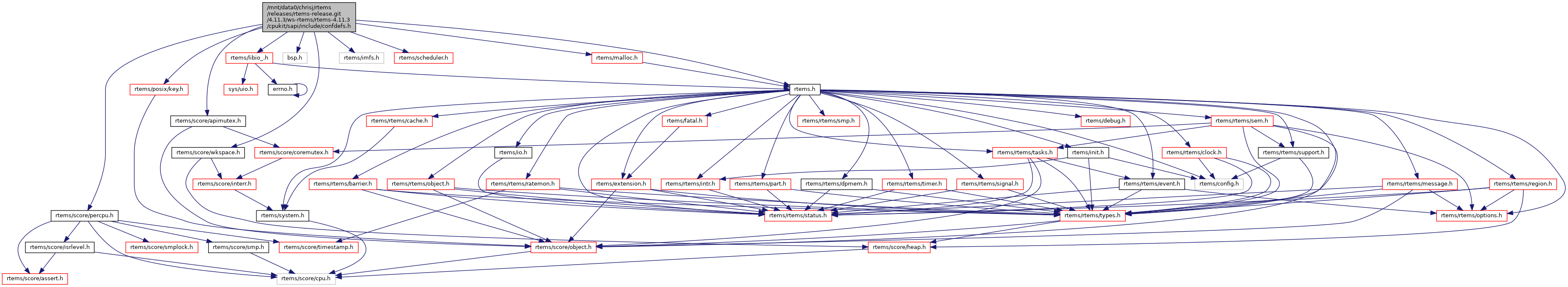

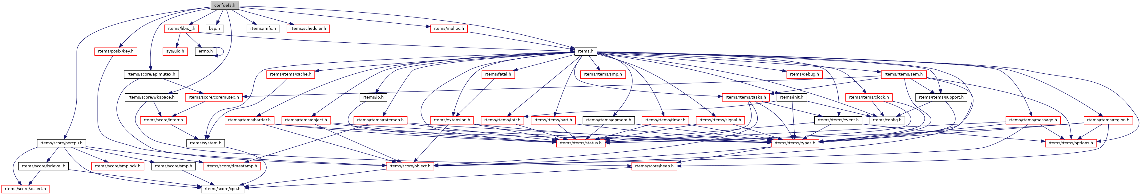

Include dependency graph for confdefs.h:
