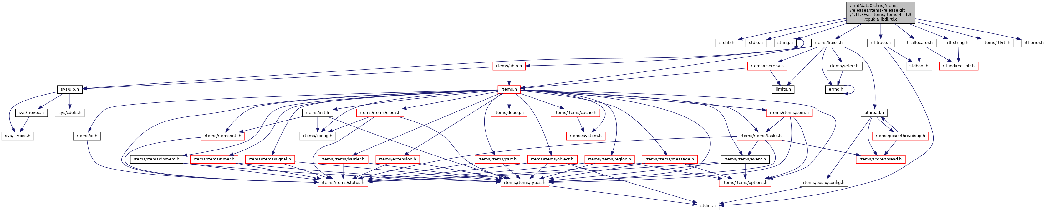

#include <stdlib.h>#include <stdio.h>#include <string.h>#include <rtems/libio_.h>#include <rtems/rtl/rtl.h>#include "rtl-allocator.h"#include "rtl-error.h"#include "rtl-string.h"#include "rtl-trace.h"
