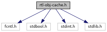

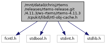

#include <fcntl.h>#include <stdbool.h>#include <stdint.h>#include <stdlib.h>
