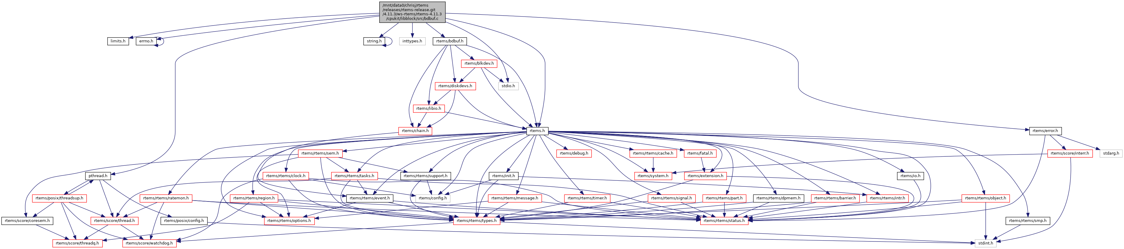

#include <limits.h>#include <errno.h>#include <stdio.h>#include <string.h>#include <inttypes.h>#include <pthread.h>#include <rtems.h>#include <rtems/error.h>#include "rtems/bdbuf.h"
