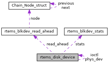

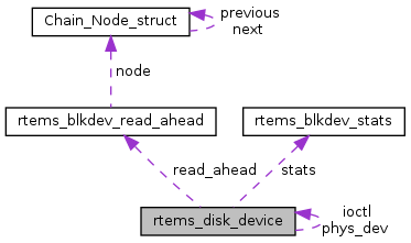

Description of a disk device (logical and physical disks). More...
#include <diskdevs.h>
Data Fields | |
| dev_t | dev |
| Device identifier (concatenation of major and minor number). | |
| rtems_disk_device * | phys_dev |
Physical device identifier (equals the dev entry if it specifies a physical device). | |
| uint32_t | capabilities |
| Driver capabilities. | |
| char * | name |
| Disk device name. | |
| unsigned | uses |
| Usage counter. More... | |
| rtems_blkdev_bnum | start |
| Start media block number. More... | |
| rtems_blkdev_bnum | size |
| Size of the physical or logical disk in media blocks. | |
| uint32_t | media_block_size |
| Media block size in bytes. More... | |
| uint32_t | block_size |
| Block size in bytes. More... | |
| rtems_blkdev_bnum | block_count |
| Block count. More... | |
| uint32_t | media_blocks_per_block |
| Media blocks per device blocks. More... | |
| int | block_to_media_block_shift |
| Block to media block shift. More... | |
| size_t | bds_per_group |
| Buffer descriptors per group count. More... | |
| rtems_block_device_ioctl | ioctl |
| IO control handler for this disk. | |
| void * | driver_data |
| Private data for the disk driver. | |
| bool | deleted |
| Indicates that this disk should be deleted as soon as the last user releases this disk. | |
| rtems_blkdev_stats | stats |
| Device statistics for this disk. | |
| rtems_blkdev_read_ahead | read_ahead |
| Read-ahead control for this disk. | |
An array of pointer tables to rtems_disk_device structures is maintained. The first table will be indexed by the major number and the second table will be indexed by the minor number. This allows quick lookup using a data structure of moderated size.
