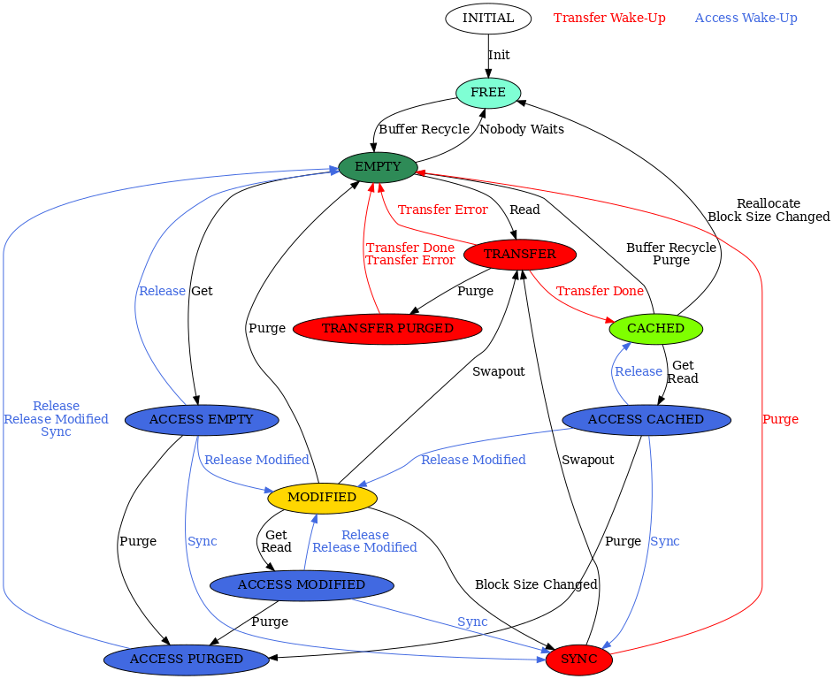

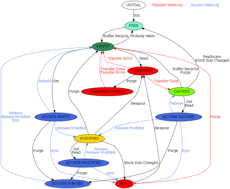

The buffers are held in various lists in the cache. All buffers follow this state machine:
Empty or cached buffers are added to the LRU list and removed from this queue when a caller requests a buffer. This is referred to as getting a buffer in the code and the event get in the state diagram. The buffer is assigned to a block and inserted to the AVL based on the block/device key. If the block is to be read by the user and not in the cache it is transfered from the disk into memory. If no buffers are on the LRU list the modified list is checked. If buffers are on the modified the swap out task will be woken. The request blocks until a buffer is available for recycle.
A block being accessed is given to the file system layer and not accessible to another requester until released back to the cache. The same goes to a buffer in the transfer state. The transfer state means being read or written. If the file system has modified the block and releases it as modified it placed on the cache's modified list and a hold timer initialised. The buffer is held for the hold time before being written to disk. Buffers are held for a configurable period of time on the modified list as a write sets the state to transfer and this locks the buffer out from the file system until the write completes. Buffers are often accessed and modified in a series of small updates so if sent to the disk when released as modified the user would have to block waiting until it had been written. This would be a performance problem.
The code performs multiple block reads and writes. Multiple block reads or read-ahead increases performance with hardware that supports it. It also helps with a large cache as the disk head movement is reduced. It however is a speculative operation so excessive use can remove valuable and needed blocks from the cache. The read-ahead is triggered after two misses of ascending consecutive blocks or a read hit of a block read by the most-resent read-ahead transfer. The read-ahead works per disk, but all transfers are issued by the read-ahead task.
The cache has the following lists of buffers:
A cache look-up will be performed to find a suitable buffer. A suitable buffer is one that matches the same allocation size as the device the buffer is for. The a buffer's group has no buffers in use with the file system or driver the group is reallocated. This means the buffers in the group are invalidated, resized and placed on the LRU queue. There is a performance issue with this design. The reallocation of a group may forced recently accessed buffers out of the cache when they should not. The design should be change to have groups on a LRU list if they have no buffers in use.

State of a buffer of the cache.
The state has several implications. Depending on the state a buffer can be in the AVL tree, in a list, in use by an entity and a group user or not.
| State | Valid Data | AVL Tree | LRU List | Modified List | Synchronization List | Group User | External User |
| FREE | X | ||||||
| EMPTY | X | ||||||
| CACHED | X | X | X | ||||
| ACCESS CACHED | X | X | X | X | |||
| ACCESS MODIFIED | X | X | X | X | |||
| ACCESS EMPTY | X | X | X | ||||
| ACCESS PURGED | X | X | X | ||||
| SYNC | X | X | X | X | |||
| TRANSFER | X | X | X | X | |||
| TRANSFER PURGED | X | X | X |
