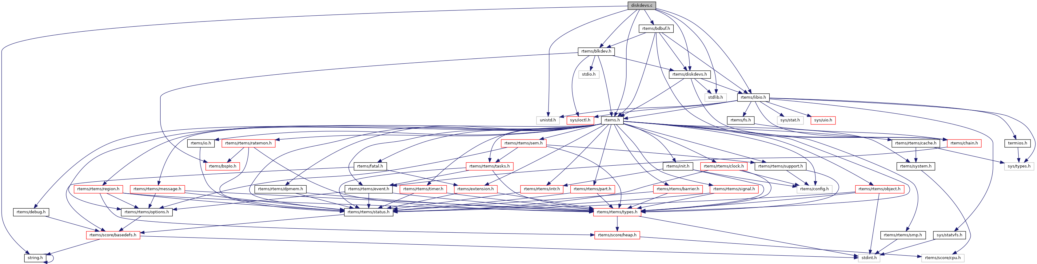

Include dependency graph for diskdevs.c:
