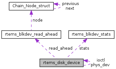

Collaboration diagram for rtems_disk_device:
Collaboration graph
[legend]
