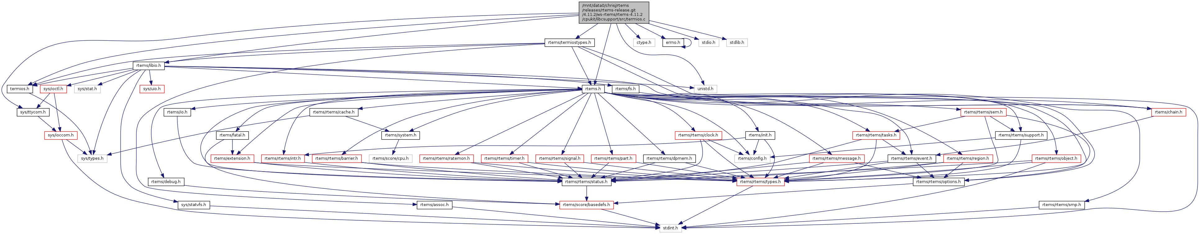

#include <rtems.h>#include <rtems/libio.h>#include <ctype.h>#include <errno.h>#include <stdio.h>#include <stdlib.h>#include <termios.h>#include <unistd.h>#include <sys/ttycom.h>#include <rtems/termiostypes.h>
