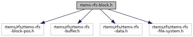

Include dependency graph for rtems-rfs-block.h:
