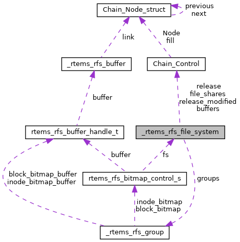

Collaboration diagram for _rtems_rfs_file_system:
Collaboration graph
[legend]
