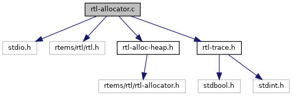

Include dependency graph for rtl-allocator.c:
