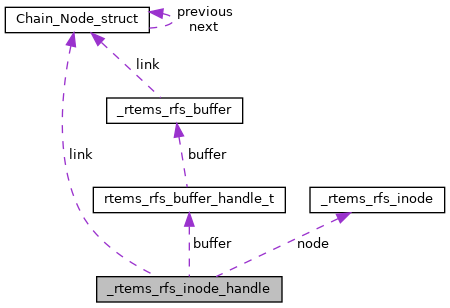

Collaboration diagram for _rtems_rfs_inode_handle:
Collaboration graph
[legend]
rtems_chain_node link
 Handles can be linked as a list for easy processing.
rtems_rfs_ino ino
 The ino for this handle.
rtems_rfs_inodenode
 The pointer to the inode.
rtems_rfs_buffer_handle buffer
 The buffer that contains this inode.
rtems_rfs_buffer_block block
 The block number that holds the inode.
int offset
 The offset into the block for the inode.
int loads
 Number of load requests.
