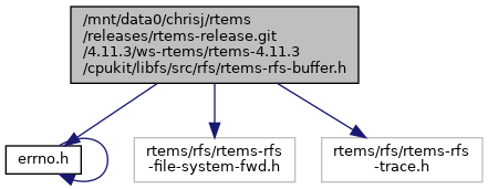

#include <rtems/rfs/rtems-rfs-file-system-fwd.h>
#include <rtems/rfs/rtems-rfs-trace.h>
Include dependency graph for rtems-rfs-buffer.h:
