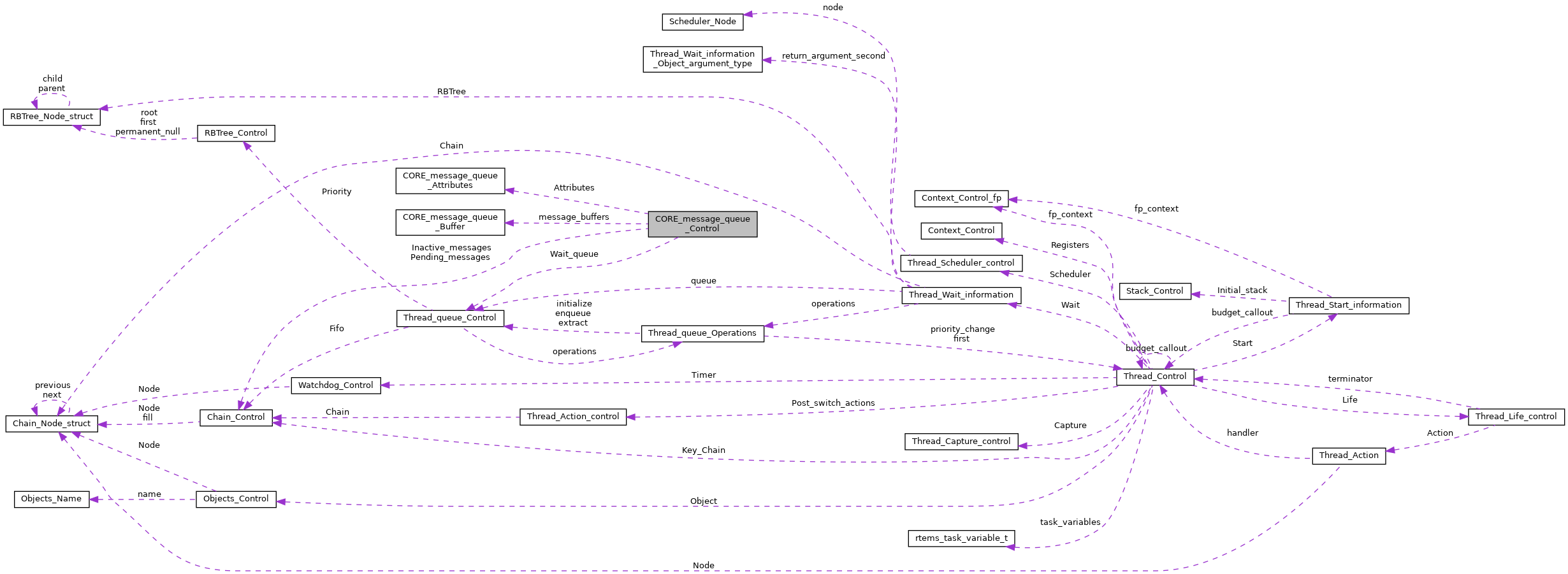

Collaboration diagram for CORE_message_queue_Control:
Collaboration graph
[legend]
Thread_queue_Control Wait_queue
 This field is the Waiting Queue used to manage the set of tasks which are blocked waiting to receive a message from this queue.
CORE_message_queue_Attributes Attributes
 This element is the set of attributes which define this instance's behavior.
uint32_t maximum_pending_messages
 This element is maximum number of messages which may be pending at any given time.
uint32_t number_of_pending_messages
 This element is the number of messages which are currently pending.
size_t maximum_message_size
 This is the size in bytes of the largest message which may be sent via this queue.
Chain_Control Pending_messages
 This chain is the set of pending messages. More...
CORE_message_queue_Buffermessage_buffers
 This is the address of the memory allocated for message buffers. More...
Chain_Control Inactive_messages
 This chain is the set of inactive messages. More...
