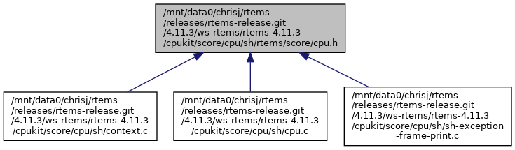

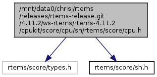

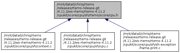

cpu.h File Reference
#include <rtems/score/types.h>
#include <rtems/score/sh.h>
Include dependency graph for cpu.h:
