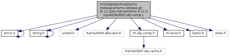

RTEMS Run-Time Linker Object Compression manages a compress stream of data. More...
#include <unistd.h>
#include <rtems/rtl/rtl-allocator.h>
#include "rtl-obj-comp.h"
#include "rtl-error.h"
#include "fastlz.h"
