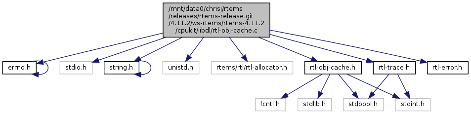

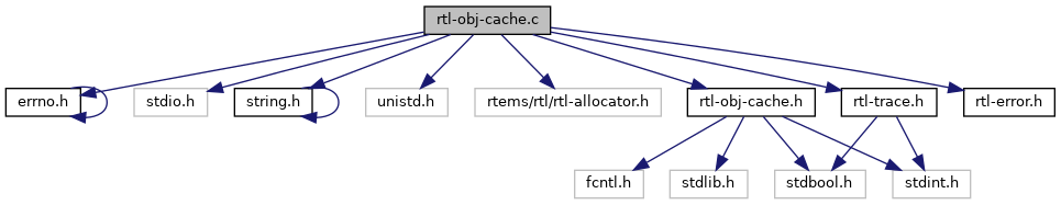

#include <unistd.h>
#include <rtems/rtl/rtl-allocator.h>
#include "rtl-obj-cache.h"
#include "rtl-error.h"
#include "rtl-trace.h"
Include dependency graph for rtl-obj-cache.c:
