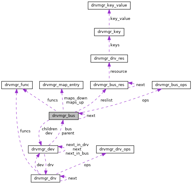

Collaboration diagram for drvmgr_bus:
Collaboration graph
[legend]
int obj_type
 DRVMGR_OBJ_BUS.
unsigned char bus_type
 Type of bus.
unsigned char depth
 Bus level distance from root bus.
struct drvmgr_bus * next
 Next Bus.
struct drvmgr_dev * dev
 Bus device, the hardware... More...
void * priv
 Private data structure used by BUS driver.
struct drvmgr_dev * children
 Hardware devices on this bus.
struct drvmgr_bus_ops * ops
 Bus operations supported by this bus driver.
struct drvmgr_func * funcs
 Extra operations.
int dev_cnt
 Number of devices this bus has.
struct drvmgr_bus_res * reslist
 Bus resources, head of a linked list of resources. More...
struct drvmgr_map_entry * maps_up
 Map Translation, array of address spaces upstreams to CPU.
struct drvmgr_map_entry * maps_down
 Map Translation, array of address spaces downstreams to Hardware.
int level
 Initialization Level of Bus.
int state
 Init State of Bus, BUS_STATE_*.
int error
 Return code from bus->ops->initN()
