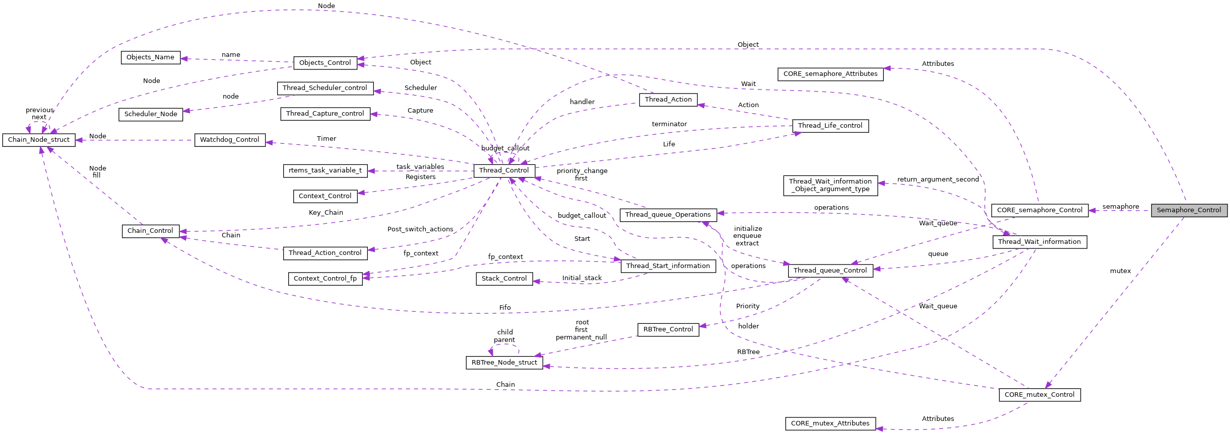

Collaboration diagram for Semaphore_Control:
Collaboration graph
[legend]
Objects_Control Object
 This field is the object management portion of a Semaphore instance. More...
rtems_attribute attribute_set
 This is the Classic API attribute provided to the create directive. More...
union {
   CORE_mutex_Control   mutex
 This is the SuperCore Mutex instance associated with this Classic API Semaphore instance.
   CORE_semaphore_Control   semaphore
 This is the SuperCore Semaphore instance associated with this Classic API Semaphore instance.
} Core_control
 This contains the memory associated with the SuperCore Semaphore or Mutex instance that provides the primary functionality of each Classic API Semaphore instance. More...
