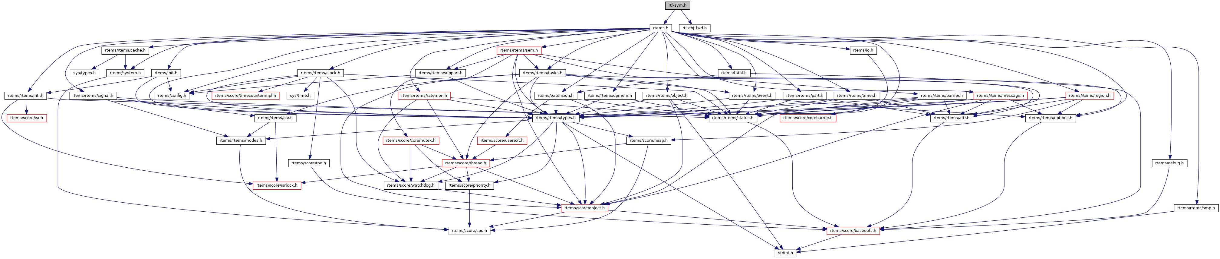

#include "rtl-obj-fwd.h"
Include dependency graph for rtl-sym.h:
