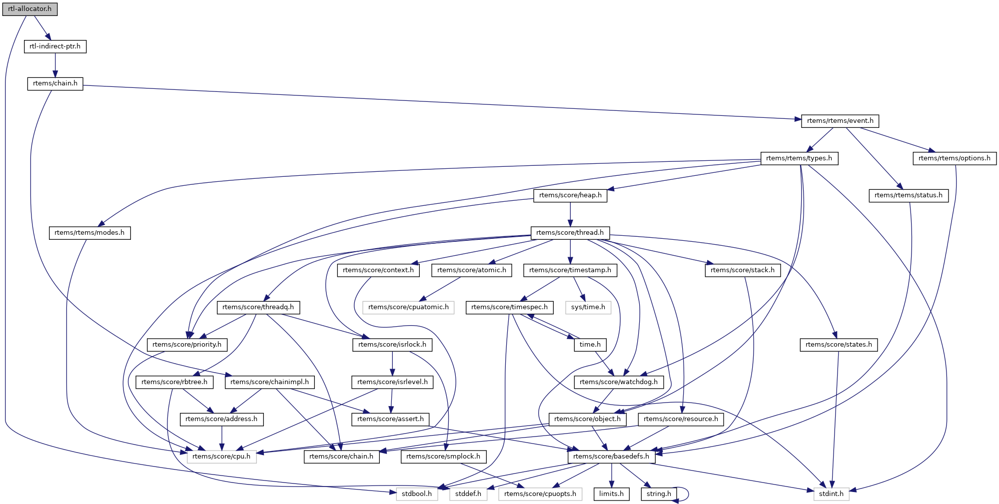

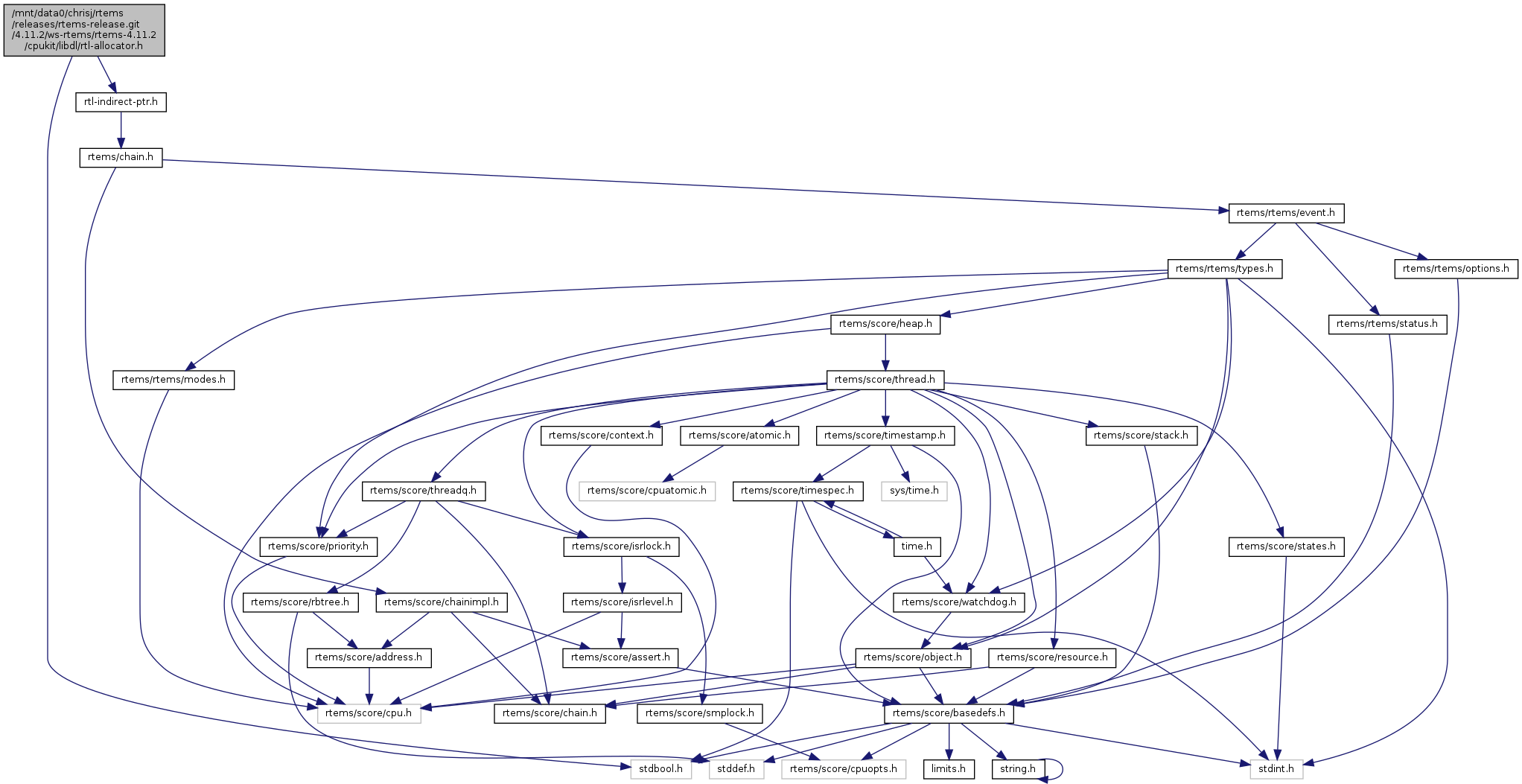

#include <stdbool.h>
#include "rtl-indirect-ptr.h"
Include dependency graph for rtl-allocator.h:
