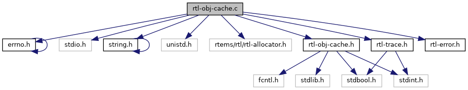

Include dependency graph for rtl-obj-cache.c:
