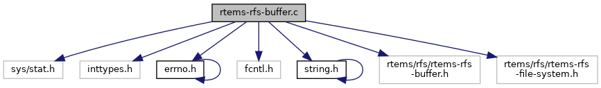

Include dependency graph for rtems-rfs-buffer.c:
