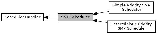

Modules | |
| Deterministic Priority SMP Scheduler | |
| This is an implementation of the global fixed priority scheduler (G-FP). | |
| Simple Priority SMP Scheduler | |
| The Simple Priority SMP Scheduler allocates a processor for the processor count highest priority ready threads. | |

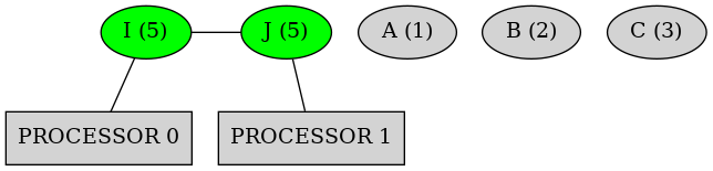

During system initialization each processor of the scheduler instance starts with an idle thread assigned to it. Lets have a look at an example with two idle threads I and J with priority 5. We also have blocked threads A, B and C with priorities 1, 2 and 3 respectively. The scheduler nodes are ordered with respect to the thread priority from left to right in the below diagrams. The highest priority node (lowest priority number) is the leftmost node. Since the processor assignment is independent of the thread priority the processor indices may move from one state to the other.

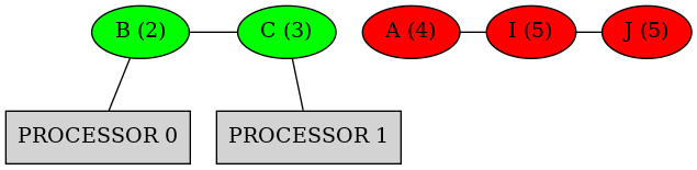

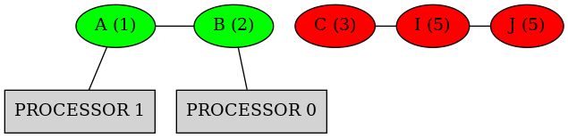

Lets start B.

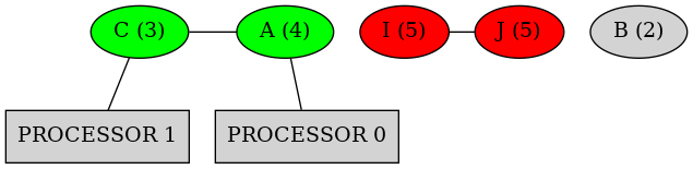

Lets change the priority of thread A to 4.

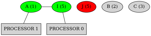

Now perform a blocking operation with thread B. Please note that thread A migrated now from processor 0 to processor 1 and thread C still executes on processor 1.
