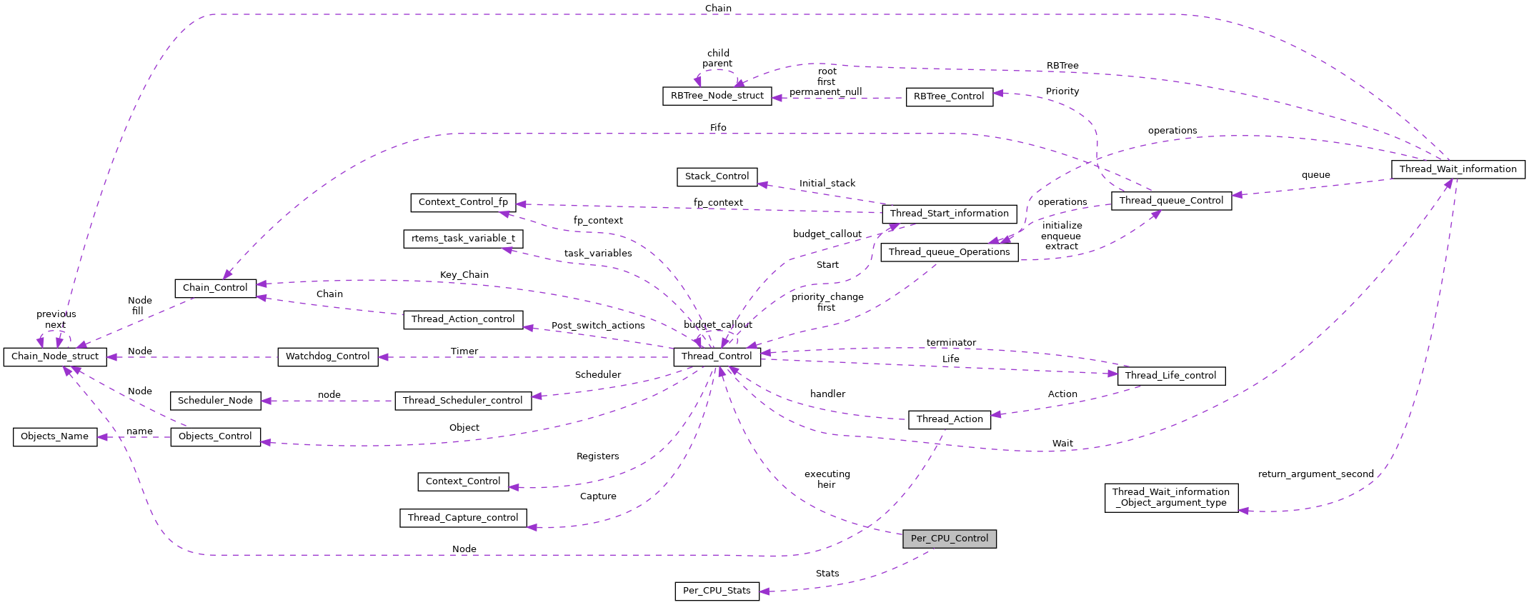

Collaboration diagram for Per_CPU_Control:
Collaboration graph
[legend]
