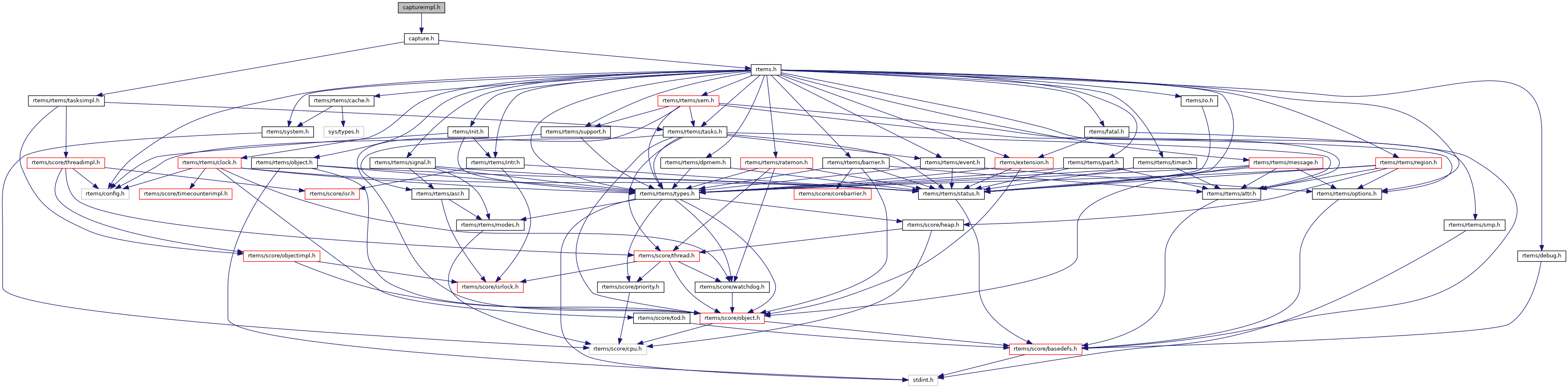

Include dependency graph for captureimpl.h:
