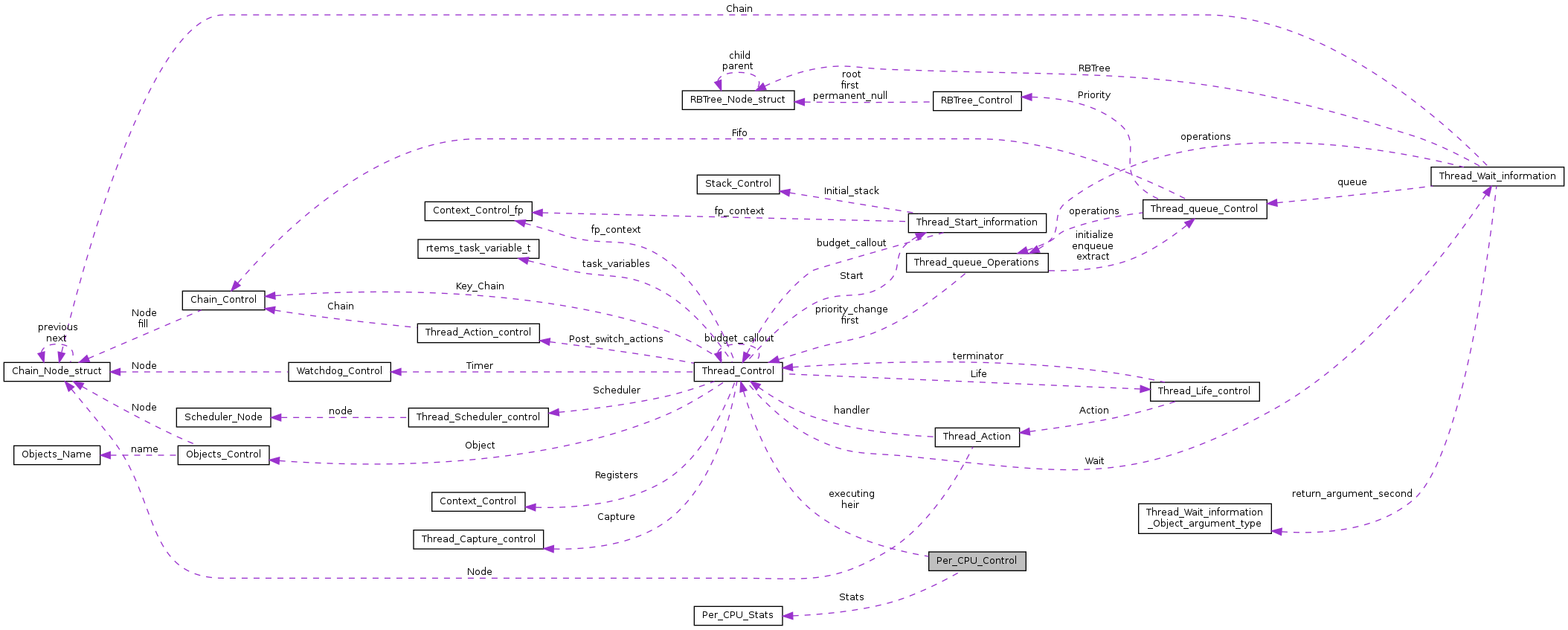

Per CPU Core Structure.
This structure is used to hold per core state information.
