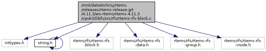

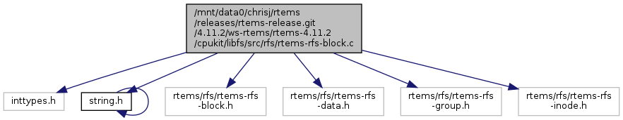

RTEMS File Systems Block RoutinesThese functions manage blocks in the RFS file system. More...
#include <inttypes.h>#include <string.h>#include <rtems/rfs/rtems-rfs-block.h>#include <rtems/rfs/rtems-rfs-data.h>#include <rtems/rfs/rtems-rfs-group.h>#include <rtems/rfs/rtems-rfs-inode.h>
