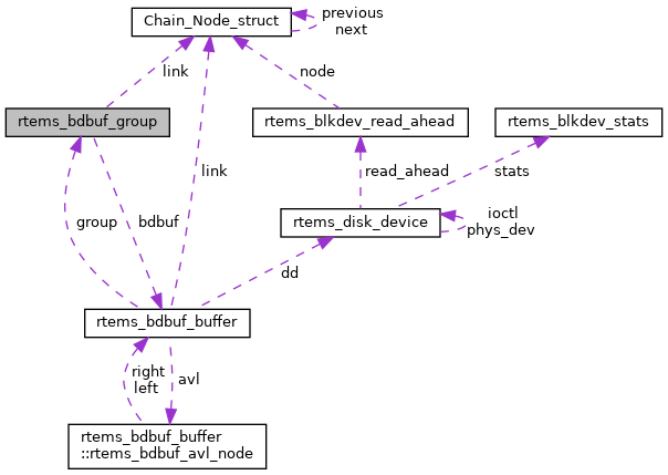

Collaboration diagram for rtems_bdbuf_group:
Collaboration graph
[legend]
rtems_chain_node link
 Link the groups on a LRU list if they have no buffers in use. More...
size_t bds_per_group
 The number of BD allocated to this group. More...
uint32_t users
 How many users the block has. More...
rtems_bdbuf_bufferbdbuf
 First BD this block covers. More...
A group is a continuous block of buffer descriptors.
A group covers the maximum configured buffer size and is the allocation size for the buffers to a specific buffer size. If you allocate a buffer to be a specific size, all buffers in the group, if there are more than 1 will also be that size. The number of buffers in a group is a multiple of 2, ie 1, 2, 4, 8, etc.
