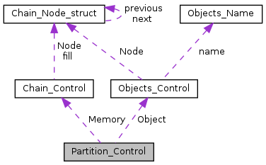

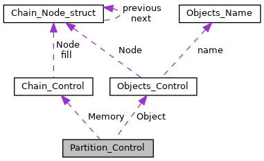

Collaboration diagram for Partition_Control:
Collaboration graph
[legend]
Objects_Control Object
 This field is the object management portion of a Partition instance. More...
void * starting_address
 This field is the physical starting address of the Partition. More...
intptr_t length
 This field is the size of the Partition in bytes. More...
uint32_t buffer_size
 This field is the size of each buffer in bytes.
rtems_attribute attribute_set
 This field is the attribute set provided at create time. More...
uint32_t number_of_used_blocks
 This field is the of allocated buffers. More...
Chain_Control Memory
 This field is the chain used to manage unallocated buffers. More...
