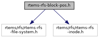

Include dependency graph for rtems-rfs-block-pos.h:
