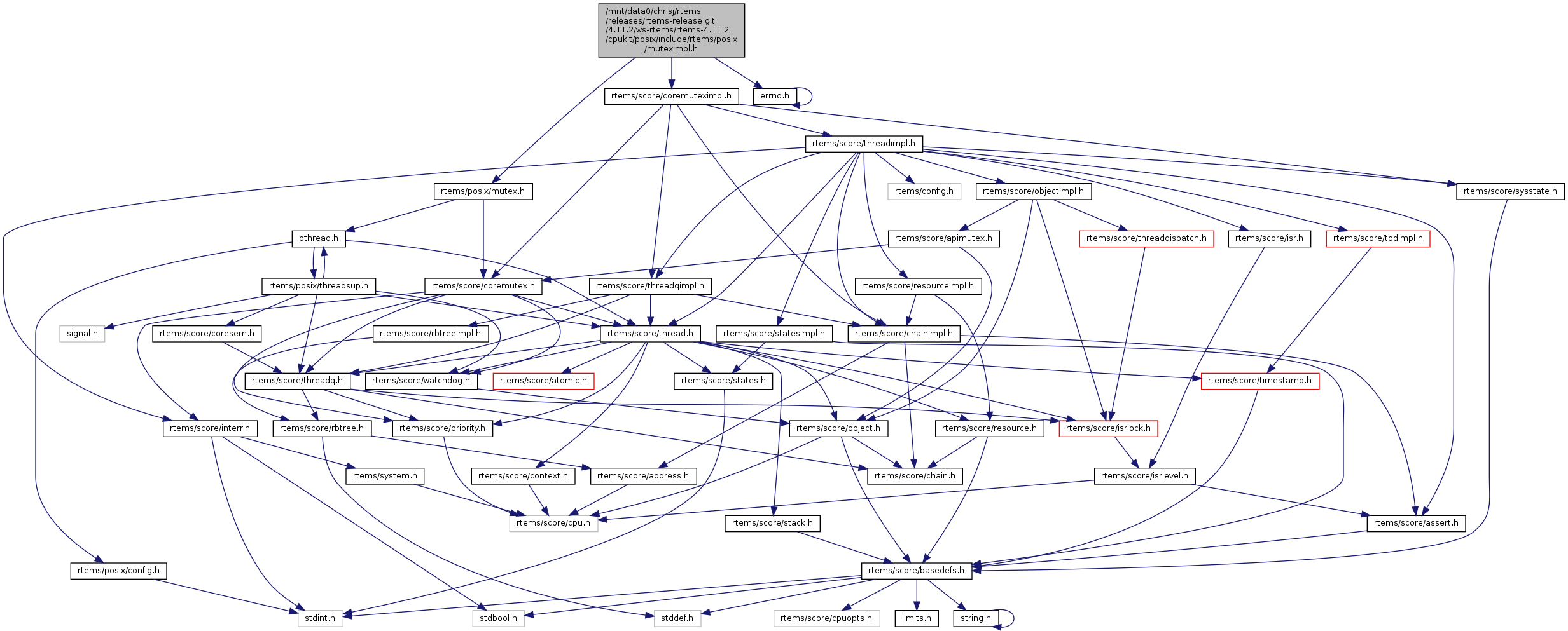

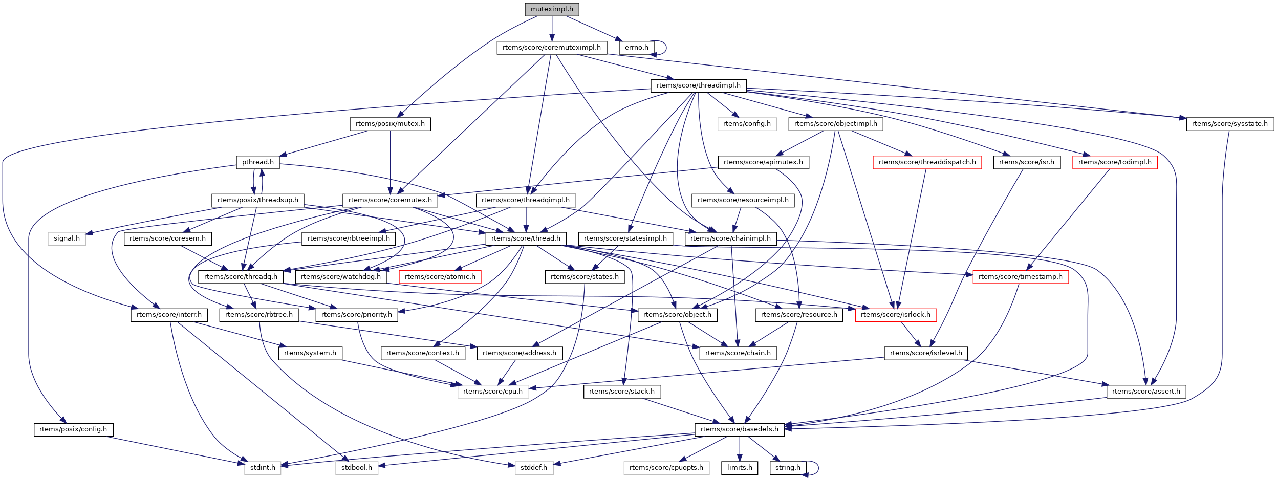

#include <rtems/posix/mutex.h>
Include dependency graph for muteximpl.h:
