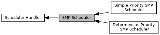

Modules | Files | Data Structures | Typedefs | Enumerations | Functions | Variables
The scheduler nodes can be in four states. More...

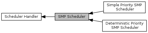

Collaboration diagram for SMP Scheduler:
 Deterministic Priority SMP Scheduler
 This is an implementation of the global fixed priority scheduler (G-FP).
 Simple Priority SMP Scheduler
 The Simple Priority SMP Scheduler allocates a processor for the processor count highest priority ready threads.
file  schedulersmp.h
 SMP Scheduler API.
file  schedulersmpimpl.h
 SMP Scheduler Implementation.

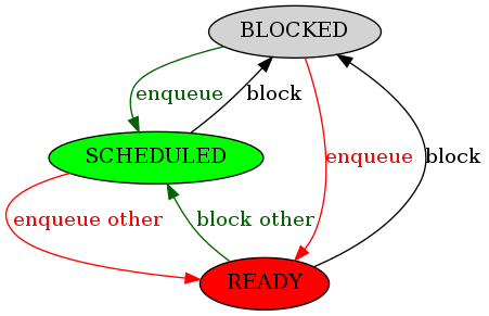

State transitions are triggered via basic operations

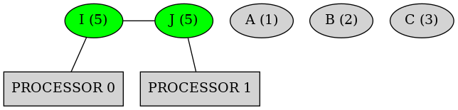

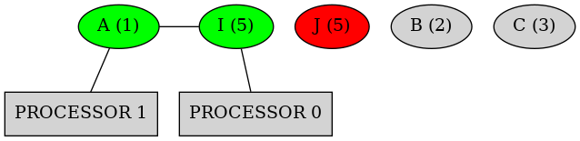

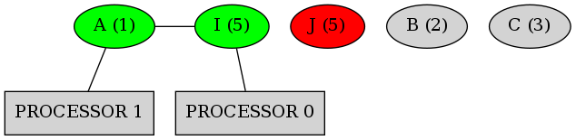

During system initialization each processor of the scheduler instance starts with an idle thread assigned to it. Lets have a look at an example with two idle threads I and J with priority 5. We also have blocked threads A, B and C with priorities 1, 2 and 3 respectively. The scheduler nodes are ordered with respect to the thread priority from left to right in the below diagrams. The highest priority node (lowest priority number) is the leftmost node. Since the processor assignment is independent of the thread priority the processor indices may move from one state to the other.
Lets start A. For this an enqueue operation is performed.

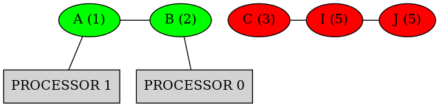

Lets start C.

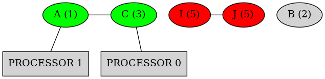

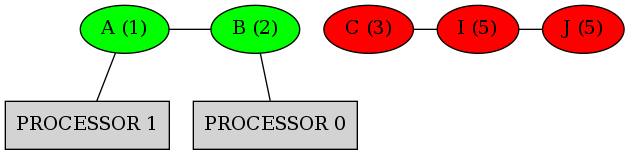

Lets start B.

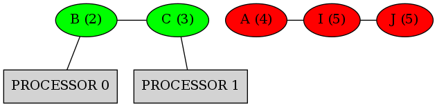

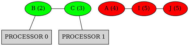

Lets change the priority of thread A to 4.
Now perform a blocking operation with thread B. Please note that thread A migrated now from processor 0 to processor 1 and thread C still executes on processor 1.
Enumeration Type Documentation
◆ Scheduler_SMP_Node_state
SMP scheduler node states.
SCHEDULER_SMP_NODE_BLOCKED
This scheduler node is blocked.
A scheduler node is blocked if the corresponding thread is not ready.
SCHEDULER_SMP_NODE_SCHEDULED
The scheduler node is scheduled.
A scheduler node is scheduled if the corresponding thread is ready and the scheduler allocated a processor for it. A scheduled node is assigned to exactly one processor. The count of scheduled nodes in this scheduler instance equals the processor count owned by the scheduler instance.
SCHEDULER_SMP_NODE_READY
This scheduler node is ready.
A scheduler node is ready if the corresponding thread is ready and the scheduler did not allocate a processor for it.
