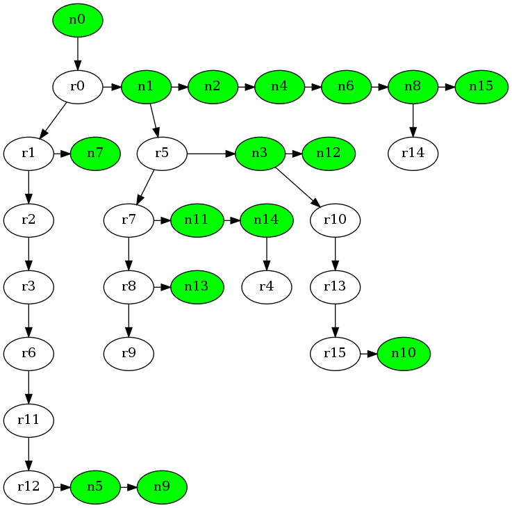

A resource is something that has at most one owner at a time and may have multiple rivals in case an owner is present. The owner and rivals are impersonated via resource nodes. A resource is represented via the resource control structure. The resource controls and nodes are organized as trees. It is possible to detect deadlocks via such a resource tree. The _Resource_Iterate() function can be used to iterate through such a resource tree starting at a top node.
The following diagram shows an example resource tree with sixteen resource nodes n0 up to n15 and sixteen resources r0 up to r15. The root of this tree is n0. As a use case threads can be associated with resource nodes. In this case a thread represented by node n0 owns resources r0, r1, r2, r3, r6, r11 and r12 and is in the ready state. The threads represented by nodes n1 up to n15 wait directly or indirectly via resources owned by n0 and are in a blocked state.

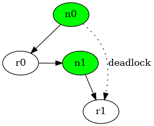

The following example illustrates a deadlock situation. The root of the tree tries to get ownership of a resource owned by one of its children.
