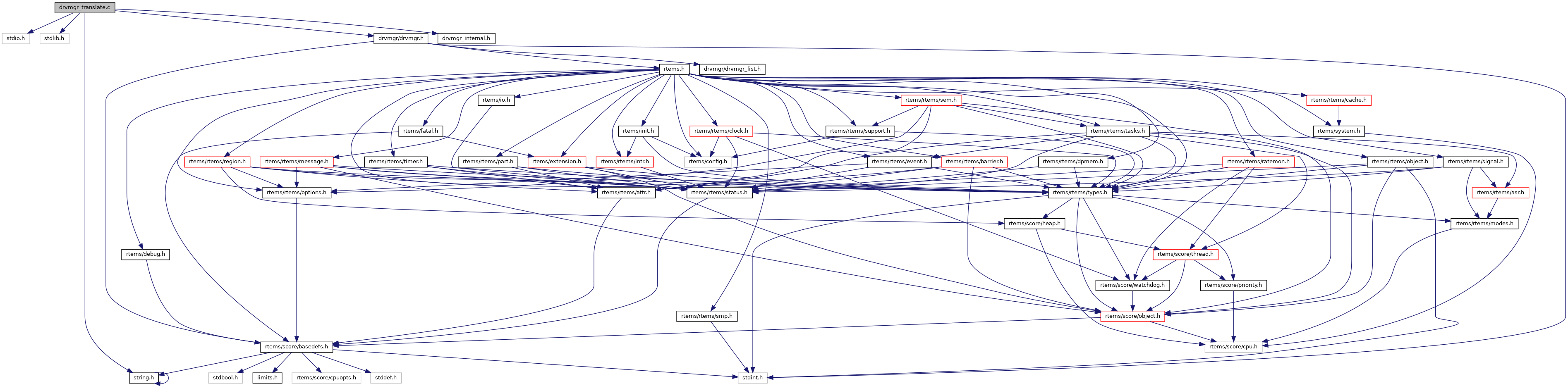

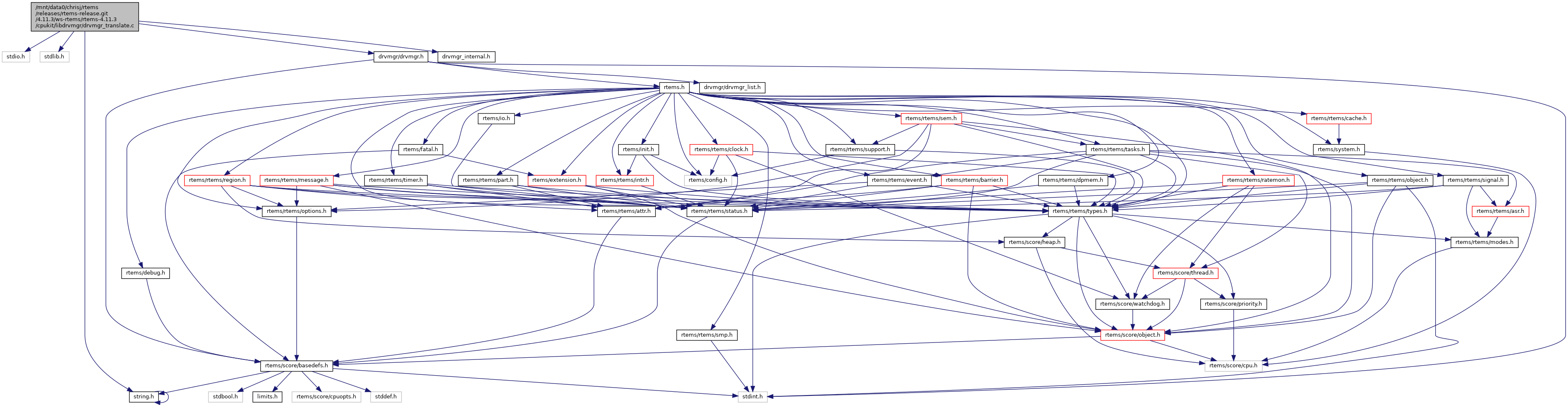

Include dependency graph for drvmgr_translate.c:
