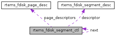

Flash Segment Control holds the pointer to the segment, number of pages, various page stats and the memory copy of the page descriptors. More...
Data Fields | |
| struct rtems_fdisk_segment_ctl * | next |
| Segments with available pages are maintained as a linked list. | |
| const rtems_fdisk_segment_desc * | descriptor |
| The descriptor provided by the low-level driver. | |
| uint32_t | device |
| The device this segment resides on. | |
| uint32_t | segment |
| The segment in the device. More... | |
| rtems_fdisk_page_desc * | page_descriptors |
| The in-memory ocpy of the page descriptors found at the start of the segment in the flash device. | |
