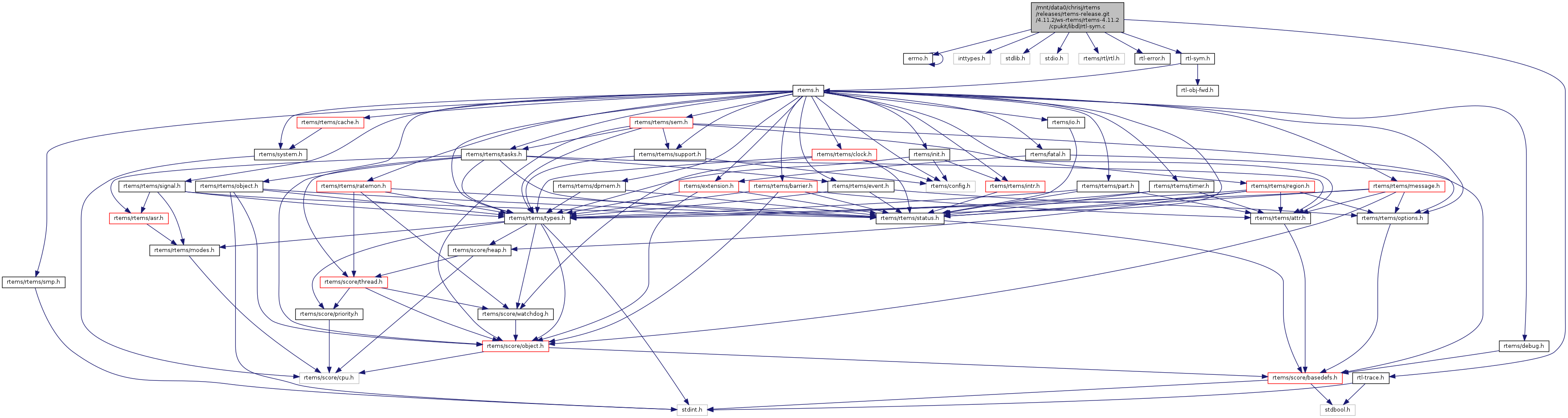

#include <errno.h>#include <inttypes.h>#include <stdlib.h>#include <stdio.h>#include <rtems/rtl/rtl.h>#include "rtl-error.h"#include "rtl-sym.h"#include "rtl-trace.h"
