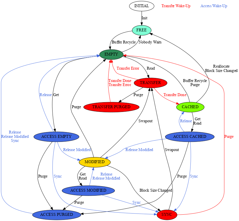

The buffers are held in various lists in the cache. All buffers follow this state machine:

State of a buffer of the cache.
The state has several implications. Depending on the state a buffer can be in the AVL tree, in a list, in use by an entity and a group user or not.
| State | Valid Data | AVL Tree | LRU List | Modified List | Synchronization List | Group User | External User |
| FREE | X | ||||||
| EMPTY | X | ||||||
| CACHED | X | X | X | ||||
| ACCESS CACHED | X | X | X | X | |||
| ACCESS MODIFIED | X | X | X | X | |||
| ACCESS EMPTY | X | X | X | ||||
| ACCESS PURGED | X | X | X | ||||
| SYNC | X | X | X | X | |||
| TRANSFER | X | X | X | X | |||
| TRANSFER PURGED | X | X | X |
