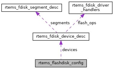

Collaboration diagram for rtems_flashdisk_config:
Collaboration graph
[legend]
