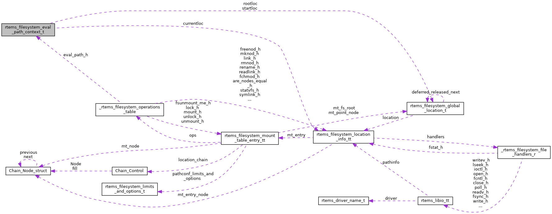

Collaboration diagram for rtems_filesystem_eval_path_context_t:
Collaboration graph
[legend]
const char * path
 The contents of the remaining path to be evaluated.
size_t pathlen
 The length of the remaining path to be evaluated.
const char * token
 The contents of the token to be evaluated with respect to the current location.
size_t tokenlen
 The length of the token to be evaluated with respect to the current location.
int flags
 The path evaluation is controlled by the following flags. More...
int recursionlevel
 Symbolic link evaluation is a recursive operation. More...
rtems_filesystem_location_info_t currentloc
 This is the current file system location of the evaluation process. More...
rtems_filesystem_global_location_t * rootloc
 The location of the root directory of the user environment during the evaluation start.
rtems_filesystem_global_location_t * startloc
 The start location of the evaluation process. More...
