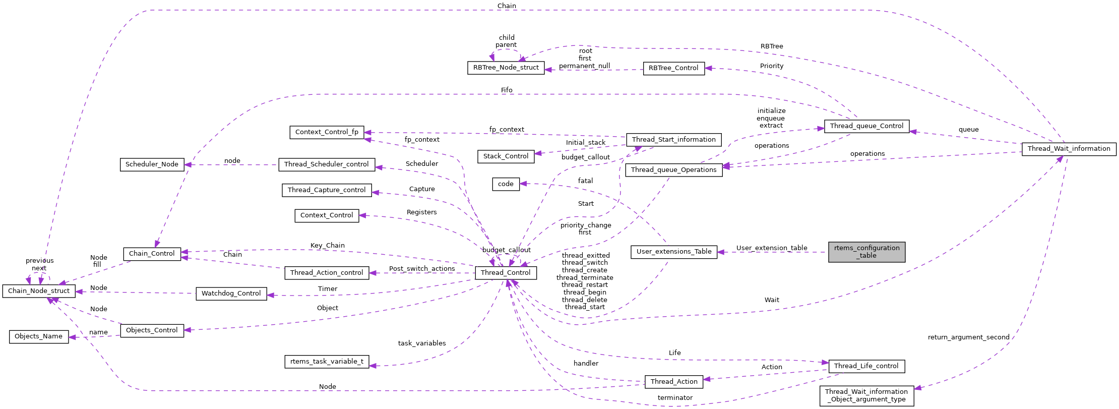

Collaboration diagram for rtems_configuration_table:
Collaboration graph
[legend]
