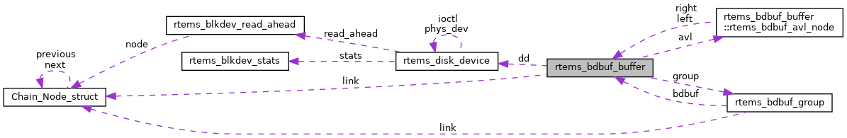

Collaboration diagram for rtems_bdbuf_buffer:
Collaboration graph
[legend]
struct  rtems_bdbuf_avl_node
rtems_chain_node link
 Link the BD onto a number of lists. More...
struct rtems_bdbuf_buffer::rtems_bdbuf_avl_node avl
rtems_disk_device * dd
 disk device
rtems_blkdev_bnum block
 block number on the device
unsigned char * buffer
 Pointer to the buffer memory area.
rtems_bdbuf_buf_state state
 State of the buffer. More...
uint32_t waiters
 The number of threads waiting on this buffer. More...
rtems_bdbuf_group * group
 Pointer to the group of BDs this BD is part of. More...
uint32_t hold_timer
 Timer to indicate how long a buffer has been held in the cache modified. More...
int references
 Allow reference counting by owner. More...
void * user
 User data. More...
To manage buffers we using buffer descriptors (BD).
A BD holds a buffer plus a range of other information related to managing the buffer in the cache. To speed-up buffer lookup descriptors are organized in AVL-Tree. The fields 'dd' and 'block' are search keys.
