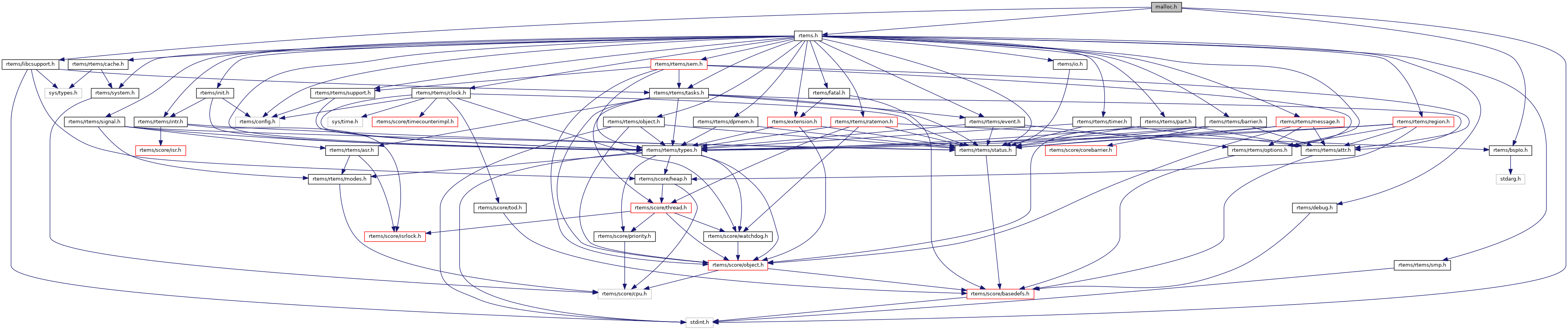

#include <rtems/bspIo.h>
#include <rtems/libcsupport.h>
#include <stdint.h>
Include dependency graph for libcsupport/include/rtems/malloc.h:
