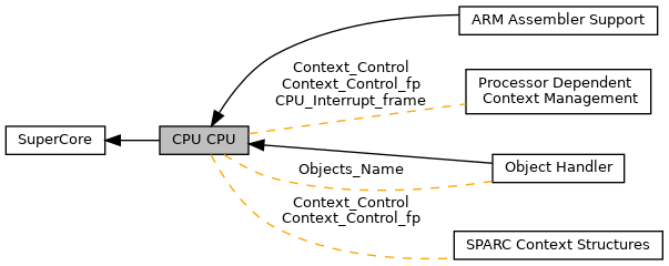

CPU CPU
Provides CPU architecture dependent services. More...
Collaboration diagram for CPU CPU:
 ARM Assembler Support
 ARM Assembler Support.
 Object Handler
