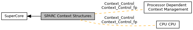

Generally there are 2 types of context to save. More...
| struct | CPU_Per_CPU_control |
| The CPU specific per-CPU control. More... | |
| struct | Context_Control |
| This defines the minimal set of integer and processor state registers that must be saved during a voluntary context switch from one thread to another. More... | |
| struct | Context_Control_fp |
| This defines the complete set of floating point registers that must be saved during any context switch from one thread to another. More... | |
This means we have the following 3 context items:
On the SPARC, we are relatively conservative in that we save most of the CPU state in the context area. The ET (enable trap) bit and the CWP (current window pointer) fields of the PSR are considered system wide resources and are not maintained on a per-thread basis.
