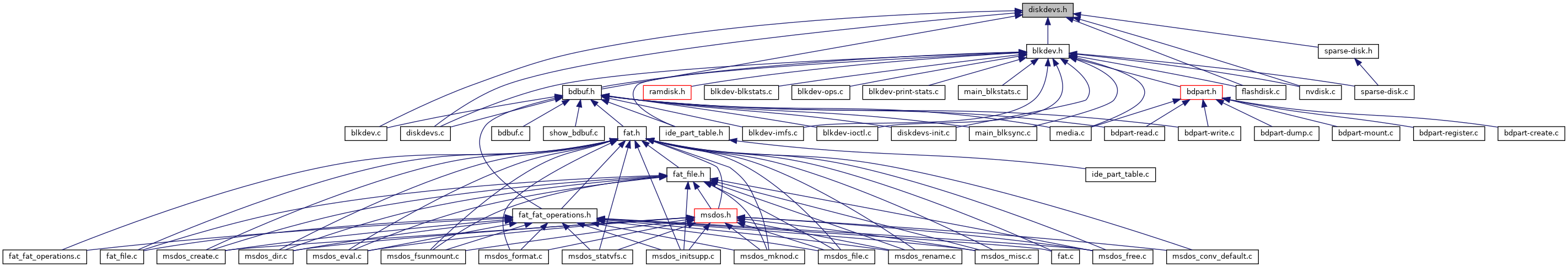

Include dependency graph for diskdevs.h:
