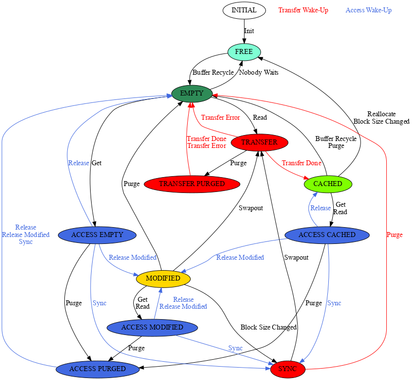

The buffers are held in various lists in the cache. All buffers follow this state machine:
Empty or cached buffers are added to the LRU list and removed from this queue when a caller requests a buffer. This is referred to as getting a buffer in the code and the event get in the state diagram. The buffer is assigned to a block and inserted to the AVL based on the block/device key. If the block is to be read by the user and not in the cache it is transfered from the disk into memory. If no buffers are on the LRU list the modified list is checked. If buffers are on the modified the swap out task will be woken. The request blocks until a buffer is available for recycle.
A block being accessed is given to the file system layer and not accessible to another requester until released back to the cache. The same goes to a buffer in the transfer state. The transfer state means being read or written. If the file system has modified the block and releases it as modified it placed on the cache's modified list and a hold timer initialised. The buffer is held for the hold time before being written to disk. Buffers are held for a configurable period of time on the modified list as a write sets the state to transfer and this locks the buffer out from the file system until the write completes. Buffers are often accessed and modified in a series of small updates so if sent to the disk when released as modified the user would have to block waiting until it had been written. This would be a performance problem.

◆ rtems_bdbuf_buf_state
State of a buffer of the cache.
The state has several implications. Depending on the state a buffer can be in the AVL tree, in a list, in use by an entity and a group user or not.
StateValid DataAVL Tree LRU ListModified ListSynchronization List Group UserExternal User
FREEX
EMPTYX
CACHEDXX X
ACCESS CACHEDXX XX
ACCESS MODIFIEDXX XX
ACCESS EMPTYX XX
ACCESS PURGEDX XX
MODIFIEDXX XX
SYNCXX XX
TRANSFERXX XX
TRANSFER PURGEDX XX
RTEMS_BDBUF_STATE_FREE
Free.
RTEMS_BDBUF_STATE_EMPTY
Empty.
RTEMS_BDBUF_STATE_CACHED
Cached.
RTEMS_BDBUF_STATE_ACCESS_CACHED
Accessed by upper layer with cached data.
RTEMS_BDBUF_STATE_ACCESS_MODIFIED
Accessed by upper layer with modified data.
RTEMS_BDBUF_STATE_ACCESS_EMPTY
Accessed by upper layer with invalid data.
RTEMS_BDBUF_STATE_ACCESS_PURGED
Accessed by upper layer with purged data.
RTEMS_BDBUF_STATE_MODIFIED
Modified by upper layer.
RTEMS_BDBUF_STATE_SYNC
Scheduled for synchronization.
RTEMS_BDBUF_STATE_TRANSFER
In transfer by block device driver.
RTEMS_BDBUF_STATE_TRANSFER_PURGED
In transfer by block device driver and purged.
