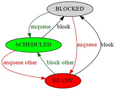

The scheduler nodes can be in four states
State transitions are triggered via basic operations

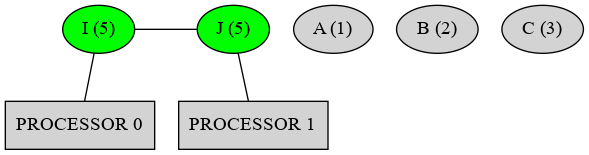

During system initialization each processor of the scheduler instance starts with an idle thread assigned to it. Lets have a look at an example with two idle threads I and J with priority 5. We also have blocked threads A, B and C with priorities 1, 2 and 3 respectively. The scheduler nodes are ordered with respect to the thread priority from left to right in the below diagrams. The highest priority node (lowest priority number) is the leftmost node. Since the processor assignment is independent of the thread priority the processor indices may move from one state to the other.

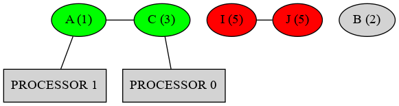

Lets start C.

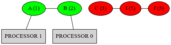

Lets start B.

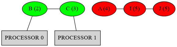

Lets change the priority of thread A to 4.

SMP scheduler node states.
SCHEDULER_SMP_NODE_BLOCKED
This scheduler node is blocked.
A scheduler node is blocked if the corresponding thread is not ready.
SCHEDULER_SMP_NODE_SCHEDULED
The scheduler node is scheduled.
A scheduler node is scheduled if the corresponding thread is ready and the scheduler allocated a processor for it. A scheduled node is assigned to exactly one processor. The count of scheduled nodes in this scheduler instance equals the processor count owned by the scheduler instance.
SCHEDULER_SMP_NODE_READY
This scheduler node is ready.
A scheduler node is ready if the corresponding thread is ready and the scheduler did not allocate a processor for it.
