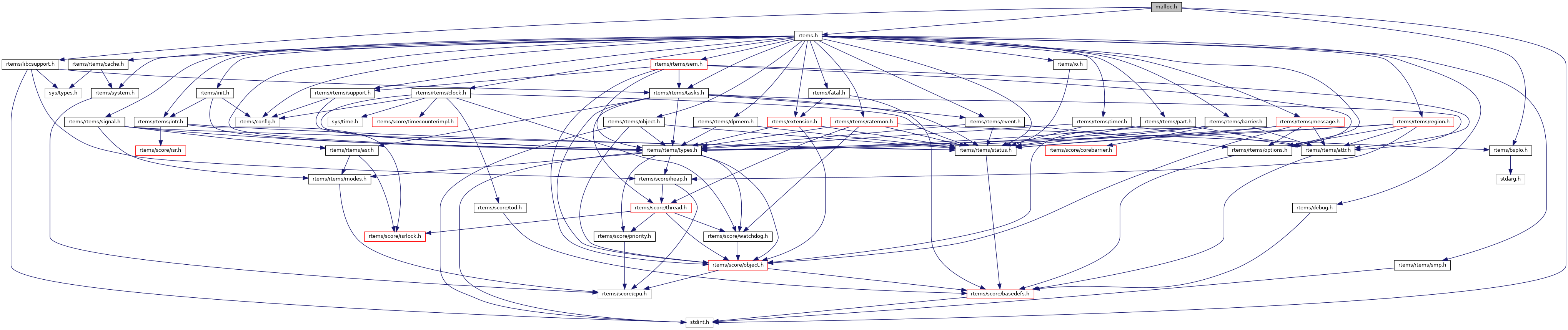

Include dependency graph for libcsupport/include/rtems/malloc.h:
